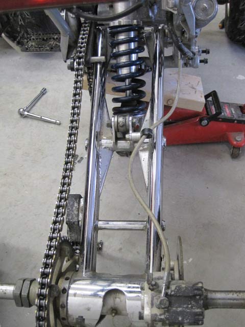

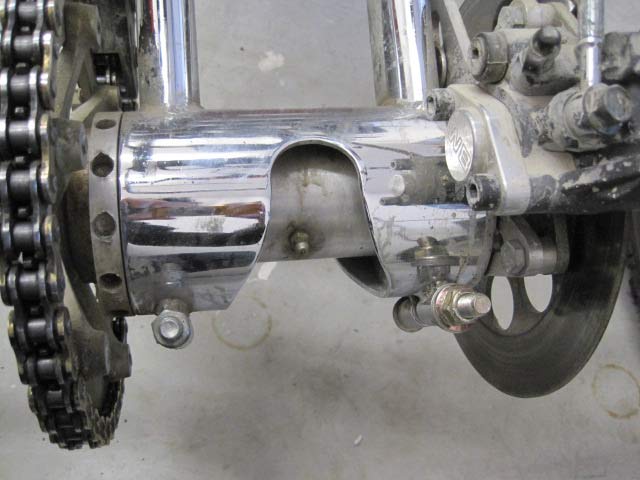

  18. Hey Guys - anyone know what type of swing arm this is? It's a +4 finished in chrome that is chipping ; ) I'm trying to identify it so I can get the proper tool for adjusting the carrier. (see the holes to the left of the carrier) The previous owner used a screwdriver by the looks of it and made a mess.
