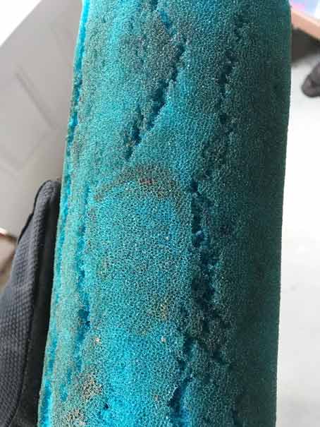

  4. It's at least 5 years oil. I use dish soap and warm water. I don't ride much and so it's only been cleaned a maximum of 3 times. Thanks.
  5. The outer shell on my durablue filter looks like it's decomposing. It's not mice. Is this happening to anyone else?

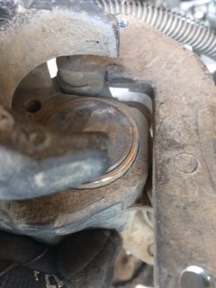

  6. On the top of the piston there is something that looks like a thick quarter. On top of that is a cap. In my case, both came out when I took the pads off. I put them back on, so it's not that important, I was just curious. I've looked at the microfiche and don't see them.
  7. I went back out to the garage and removed the parking brake and then the I was able to compress the piston all the way in. Shown in red in the pic. The outside portion goes in as well. Once I did this, the pads fit fine and I was riding. Thanks for the help. Does anyone know what the "button" and cap inside the red are for? Looks like mine was glued at one point, but now it will just fall out when the pads are out.
  8. gusto - can you tell from the photo if it should be in further? bansheeandrider - did this already, thanks. Thank you for the help.
  9. Aftermarket pads. Good thought. The piston is in as far as I can get it. (out approx. 1mm as shown in photo) Yes, cap off both reservoirs. Disk does not appear warped. Thanks guys!
  10. Hi Gents, I'm trying to install a new set of rear brake pads. Typically a dead simple job. I've opened the caliper using a c-clamp so that only about 1mm is out, as shown in the attached photo. Despite this, there is not enough room between the new pads for the disc. I checked the brake pads and they are the correct ones. Any ideas that the hell is going wrong? I must be losing my mind. Thanks.
