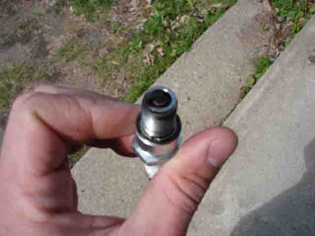

  14. ok well here is a pic of what the plug looks like, i didnt do a plug chop but that was a new plug when i got it running and has maybe 30 minutes on it. it looks like its right on. the center is a nice chocolate and the plug int wet or overly sooted. But once you get the rpms up enough and get into powerband it dosent bog but it will pop and not rev up fully and lose all power like its lean on the top. i just noticed that the plugs are br9es's. I gotta go get some 8's but could that be causing it?

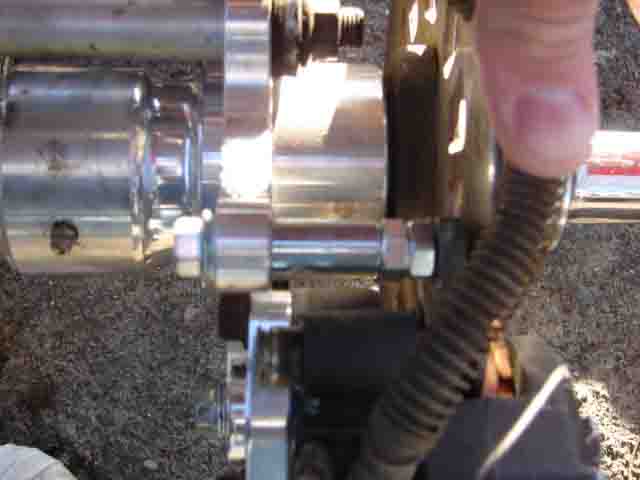

  19. I haven't had a chance to even ride my shee yet. I bought it and it was a disaster. I put the new carrier on and a new gforce axle. New trinity 2 into 1 intake and 34mm keihin pj and new modded shift star. Right now I have the clutch cover off cause the shifter had like 2 inches of play in it to find there was a broken bolt. Once I get it back together here soon it'll be riding time. I don't see where the spacer will be a problem as long as you use a good bolt and everything it tight so there is no play. Mine came with a spacer but it was 1/4" to long so I made that one. Ill certainly let you know when I get it going if it holds up though. Good luck and your welcome
  20. I bought one of the dual bearing carriers myself to find the same issue. Mine came either mounting bolts and spacers though except the spacers were 1/4" to long, LOL. I just made new spacers for about $5 at lowes and its all good. I used a 1" steel spacer with 2 nuts on the end to lock everything down nice and tight and its a 1 1/2" Metric 8x1.25 bolt. Hope that helps you out! Edit: Mine is the RAD Twin Row Carrier
