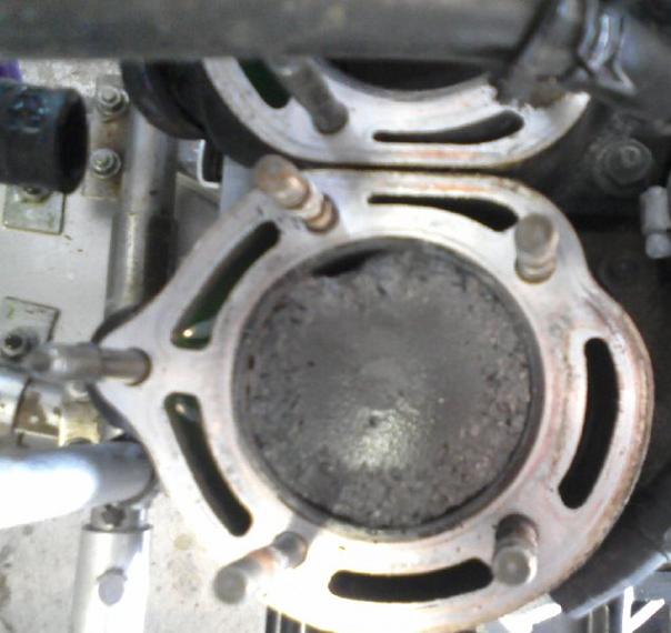

Well I thought about doing a stroker (I have a 388 ci SBC, and working on a 496 BBC) BUT I just need to throw the Banshee together this time without splitting the cases ... $$$ is sorta a issue, so that is why the questions about porting. I just don't think I can leave that much power (from the porting) on the table, since I have the cylinders off ... ~DaVe -

Well it looks as if it is unanimous, get the porting done ... Now the age old battle of Jeff or Kevin ... Thanks everyone !!! ~DaVe -

Hello, after WAY TOO MANY hours on a stock cylinder 1999 Banshee, it finally "burned down" and needs a rebuild ... The non cosmetic mods were: Pro-Tec boost bottle (going to eliminate that) Toomey's T-5 pipes, and Cascade billet exhaust clamps K&N POD filters w/ outerwear's K&T performance: Milled head (don't know how much?), Lightened flywheel, and +4 timing plus 2" rear swing arm w/ braided rear brake line Boysen power reeds W/ spacers CASCADE Clutch Disengagement Adjuster CASCADE Modified Shift segment Pro Design Billet water pump Impeller I had no problems running with my friends 450's and Raptor 700's up the hills ... But now some of them have gone to Hi-comp pistons and Hot cams ... So my plans are: NOSS cool head with 19 or 20 CC domes (I ride at St A. ID and Little S. UT both ~5000 ft) The stock head got a lot of "damage" from the rings being slammed into it So now do I have F.A.S.T or Herr Jugs do a DUNE port job on it along with the bore (I think .010 will clean it) and Wiseco pistons / rings / etc. ??? -OR- just have it bored locally, throw some pistons in it and hope it is as fast as it once was .... I'm worried about having only a "light switch" top end, I do only ride the dunes, but the quad always seemed to have excellent mid/low end performance. Also I can't imagine how, but will porting effect reliability ? I rode 2 years with less problems than some of my 4 stroke friends with NEW quads !!! (I do routine maintenance religiously) Any thoughts appreciated !!! THANKS ~DaVe

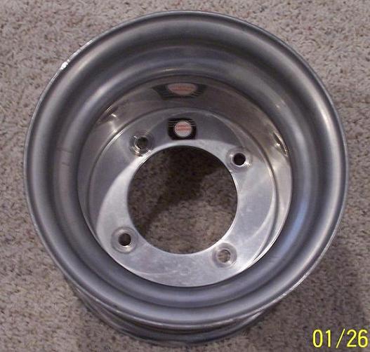

I have (1) Douglas wheel / rim if that helps at all ??? 8" x 8" Douglas BLACK label (.160 thick, 6061 heat treated aircraft grade aluminum) wheel 4/115 Bolt Pattern $25 shipped to lower 48 states ... ~DaVe
(1) 8" x 8" Douglas BLACK label (.160 thick, 6061 heat treated aircraft grade aluminum) wheel 4/115 Bolt Pattern Should fit : Yamaha 350 Banshee '87-88 & '91-06 Yamaha YFZ 450 '04-06 Yamaha 660/700 Raptor '01-06 Yamaha 350 Raptor '04-06 Yamaha 350 Warrior '87-06 $25 shipped to the lower 48 states ~DaVe

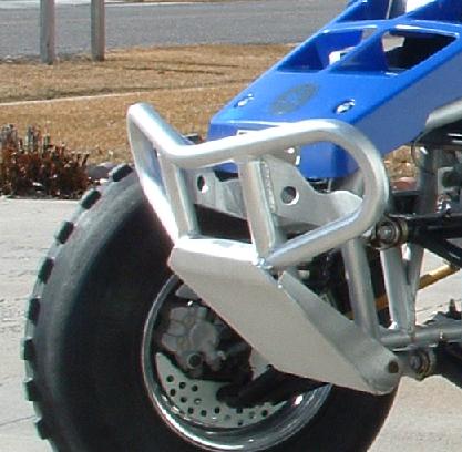

I like the all BLACK look, but do the front bumper and rear grab bar as well ~DaVe
