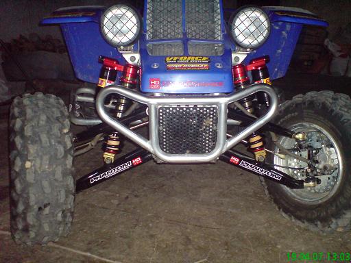

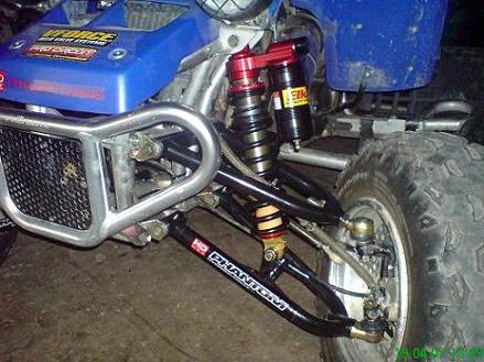

Elka compression & rebound adjustable shocks mx and crosscountry setup. HD + 2 +1 arms, the shocks did not clear the arms but with slight modification it did. Awesome mod, best mod to do first!! Unbelievable at high speeds! The picture was taken before i have cut the plastics.

..when i contact the dealer, they did not want to take the arms back, i am a mech engineer so this was easy to fix, i had to cut 5mm of the one side where the bush fits in and add it up at the front of the arm to move the arm back for the shock to clear the arm. All done and look great! Pics wil be up soon. I just dont like people who tell u a certain product wil fit on another and then if it dont they just pull up their shoulders! Anyways i am from SA so dont u worry about the dealer! -
I bought a set of (i2500) +2 +1 Hydrodynamics a arms and 4 months later elka comp&rebound adj shocks. When i ordered the a arms the dealer told me that the elka(cross country & mx) shocks wil fit on the arms, anyway when i had fit the a arms, the upper arm could slide back and forward about 1.5mm, i had to make a stainless steel washer to get rid of the gap! The second desaster was that the elka shocks's spring was to thick and the upper a arm's tubing was in its way. I had to modify the upper arm!!
