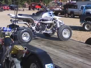

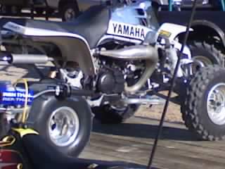

and the pics
th reason I had to Go BIG!!
new PJ's
more pics..
Jeff Sinclair, great engine builder. had me running in less than an hour and a half from just all my engine and parts in a 30 gal tote box.
on the trailer getting ready for her maiden voyage!
