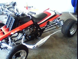

Which set of cylinders would u guys choose to put on a 7mill billet crank for 1/8th mile drag. Right now i'm running a set of A&S drag ported stock cylinders. Would you run the billet mini twisters, cheetah cubs, cheetahs, super cubs, or possibly the dm cylinders? If possible could u guys tell which would u choose and why? Im about 230 pounds on a cut stock frame. I'm trying to get to some
6.0's to 6.40's. Thanks in advance!
