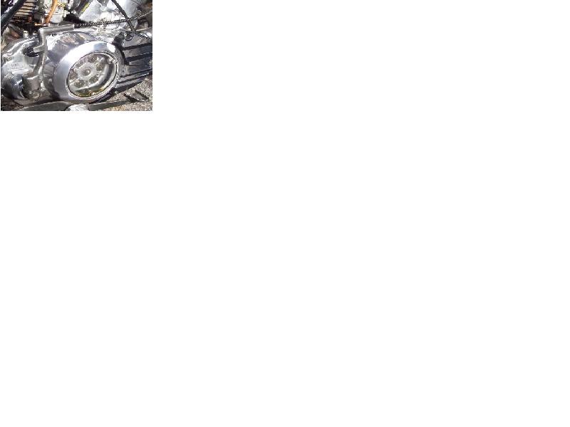

jbooker82 Posted April 9, 2008 Report Share Posted April 9, 2008 thanks alot guys ill see what i can do. Derick Direct Drive is the only way to go for the cover. The old way was to mill the stock cover and ethire weld on or epoxy on an extension ring. They have a tendency to leak if not done right. Direct Drive makes 100% bran new cast covers. So there is no weld or epoxy to fail. The cover is the expensive part, the actual lockup that bolts on top of the pressure plate is 100 bucks Direct Drive LINK Here is my direct drive cover and lockup. Quote Link to comment Share on other sites More sharing options...
BellicoseBanshee Posted April 10, 2008 Report Share Posted April 10, 2008 I like the black cover as well, good choice. :thumbsup: Quote Link to comment Share on other sites More sharing options...
