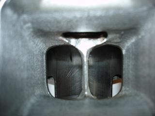

Fireroad Express Posted March 18, 2008 Report Posted March 18, 2008 works like a top! wouldn't go any narrower though. Quote
bansheejoel Posted March 18, 2008 Author Report Posted March 18, 2008 DAMN!! that intake is opened up for sure lol. yeah mine are a little thicker than that and my intake isnt that high so i think i should be good if your running that with no problems. thanks Quote
dajogejr Posted March 18, 2008 Report Posted March 18, 2008 works like a top! wouldn't go any narrower though. Somebody call the cops cause someone RAPED those intakes....sheesh.... That would make me more than nervous. Quote
BellicoseBanshee Posted March 18, 2008 Report Posted March 18, 2008 Somebody call the cops cause someone RAPED those intakes....sheesh.... That would make me more than nervous. It is a good thing that is not an exhaust bridge, it would probably melt :nuke: , haha... Quote
FireHead Posted March 18, 2008 Report Posted March 18, 2008 Somebody call the cops cause someone RAPED those intakes....sheesh.... That would make me more than nervous. Word. Looks like a ring eater to me......... Possibly Lord of the Ring eaters? :biggrin: Quote
dajogejr Posted March 18, 2008 Report Posted March 18, 2008 Word. Looks like a ring eater to me......... Possibly Lord of the Ring eaters? :biggrin: There is a gay hobit joke in there somewhere, it's just too early for me....lol. Quote
Fireroad Express Posted March 18, 2008 Report Posted March 18, 2008 (edited) DAMN!! that intake is opened up for sure lol. yeah mine are a little thicker than that and my intake isnt that high so i think i should be good if your running that with no problems. thanks no seriously though,if you want reliability, you don't want your bridges this thin! just picture your rings sliding over the intake bridge at 8000rpm. these jugs are not going to last long! they're on the early retirement plan! hobit joke: - bridge is about as thick as a baggins hair Edited March 18, 2008 by the grinch Quote

bansheejoel Posted March 19, 2008 Author Report Posted March 19, 2008 i went to another engine shop by my house tonight and they said they look fine, i measured them and there at 1/4" at the smalist spot. So i think im fine. let me know if this sounds about right. Quote
trex banshee Posted March 19, 2008 Report Posted March 19, 2008 no seriously though,if you want reliability, you don't want your bridges this thin! just picture your rings sliding over the intake bridge at 8000rpm. these jugs are not going to last long! they're on the early retirement plan! hobit joke: - bridge is about as thick as a baggins hair first of all your rings do not even go that low. BDC is a few mm above them. However im with some others i would be affraid of these, little loose bore and some piston rocking at 8000 and your gonna have some problems Quote
