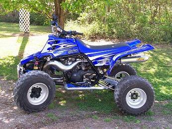

chevy7398 Posted April 24, 2007 Report Share Posted April 24, 2007 after a rear and a half and way more than i had intedened to spend i finally got her back together. the wife said im glad your finally done, i said im not done just content for now. it was a complete frame up rebuild with a lota go fast parts and it has way more power than thought she did, even more than anticipated. Quote Link to comment Share on other sites More sharing options...
chevy7398 Posted April 24, 2007 Author Report Share Posted April 24, 2007 side view Quote Link to comment Share on other sites More sharing options...
blackandyellowshee Posted April 24, 2007 Report Share Posted April 24, 2007 Very nice! What kind of motor mods do you have done? Quote Link to comment Share on other sites More sharing options...
chevy7398 Posted April 24, 2007 Author Report Share Posted April 24, 2007 a hotrods stock stroke welded crank, all new seals and bearings, new clutch, vitos power pistons, cool head with 20cc domes, adjustable timing plate set at 4 deg, v-force3 reeds, k&n filter and k&n power lid, fmf fattys and power core 2s, and the ever popular reed spacers and boost bottle Quote Link to comment Share on other sites More sharing options...
scooter Posted April 24, 2007 Report Share Posted April 24, 2007 nice job, that front suspension looks great bet it rides good too.good job Quote Link to comment Share on other sites More sharing options...
BansheeDan Posted April 24, 2007 Report Share Posted April 24, 2007 nice job, that front suspension looks great bet it rides good too.good job nice lookin shee man....... love the graphics.... Dan Quote Link to comment Share on other sites More sharing options...
chevrolet banshee Posted April 24, 2007 Report Share Posted April 24, 2007 nice man i wish i had the time and money to do that kinda stuff to my banshee how much did you spend Quote Link to comment Share on other sites More sharing options...
SoCalinIt Posted April 24, 2007 Report Share Posted April 24, 2007 Looks really nice man! Good overall build! Quote Link to comment Share on other sites More sharing options...
BumpaD_Z28 Posted April 24, 2007 Report Share Posted April 24, 2007 NICE !!! Gotta love Blue Yamaha's :) GrEaT job man !!!! Quote Link to comment Share on other sites More sharing options...
HardIzZlE Posted April 25, 2007 Report Share Posted April 25, 2007 nice banshee....do you rememeber how to ride after a year lol its 1 down 5 up lol Quote Link to comment Share on other sites More sharing options...
chevy7398 Posted April 25, 2007 Author Report Share Posted April 25, 2007 ya had a couple oh shit moments but i held on to her, so far so good, had to retighten some things but thats it Quote Link to comment Share on other sites More sharing options...
