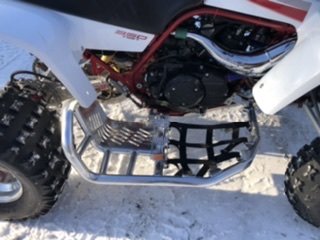

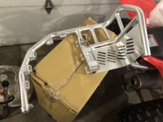

Deets Posted January 17, 2020 Report Posted January 17, 2020 When I bought my banshee, it only had one threaded block still on the frame and obviously no pegs at all. so I ordered a set of alba nerf bars and pegs. They finally came in. Quote

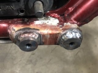

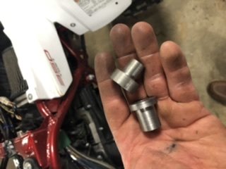

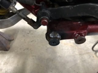

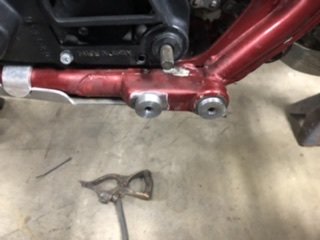

Deets Posted January 17, 2020 Author Report Posted January 17, 2020 Gunna make some threaded inserts on the lathe when I get off work and hopefully get em welded on. I’ve got the front made, just need to do the rear two. Quote
gusto Posted January 17, 2020 Report Posted January 17, 2020 That’s the way to do it. If your lazy JDS Customs sell them also Quote
Deets Posted January 17, 2020 Author Report Posted January 17, 2020 (edited) I’d rather make em than buy a set. had a couple different ideas, first thought was an all thread through the frame for the rear. But all thread would be to small for the size of the hole in the frame. Then I thought about a shaft the same size as the hole in the frame with the right size stud turned and threaded. but I’ll Probly just end up making individual inserts Edited January 17, 2020 by Deets Quote

Deets Posted January 18, 2020 Author Report Posted January 18, 2020 8 hours ago, trickedcarbine said: Short cut. This guy already has dimensions for you. I saw that a while back but didn’t find it. So I just winged it. I didn’t go back to factory spec because I didn’t see any sense in running an extra spacer to mount my alba nerf bars. so I just made em the correct size for what I had Quote

gusto Posted January 20, 2020 Report Posted January 20, 2020 On 1/17/2020 at 7:25 PM, Deets said: Excellent job! 1 Quote
Deets Posted January 20, 2020 Author Report Posted January 20, 2020 2 hours ago, SKEETER said: Ddq weld that after friday night shots ? Only took about 4 blue moons Quote
