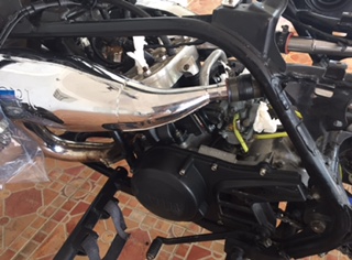

Rawnold Posted July 31, 2017 Report Posted July 31, 2017 Sup fellas, just finished a top-end rebuild on a banshee I purchased not too long ago. A lot of you may already be familiar with the quad I'm talking about ( if not, 2003 stock crank, now 66.50 bore, slight porting, CPIS, stock carbs.... 310 jet) After fresh cylinder Bore and new pistons 66.50, new domes previously 18cc now 21cc. I assembled the babe up to the head. installed the reeds,carbs, and pipes, covered up all the holes and left it at that. My question is, what should I do to the quad before running it? Obviously warm up etc before going out for a ride. But I'm going to look up on how to do a leak down test on the quad. Make sure everything is sealed properly. After that I'll probably do a compression test to make sure both sides are good. Then what should be my next move? Quote
