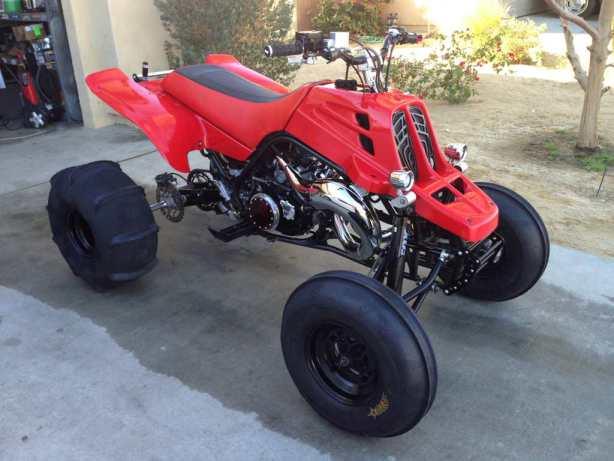

87twin350 Posted July 1, 2014 Author Report Posted July 1, 2014 hp2000, I just noticed your signature. Would this happen to be your shee? Quote
hp2000 Posted July 1, 2014 Report Posted July 1, 2014 hp2000, I just noticed your signature. Would this happen to be your shee? Yes it's mine, but that's not the one we converted. Sent from my iPhone using Tapatalk Quote
