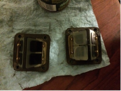

OP, have you pulled the reeds out to inspect them?
Reed seem fine. No light coming through them. Seems like the fuel isn't being pulled into the motor for some reason. As soon as I spray fuel trough the carb is runs first kick

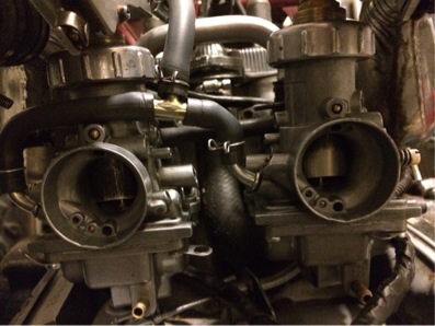

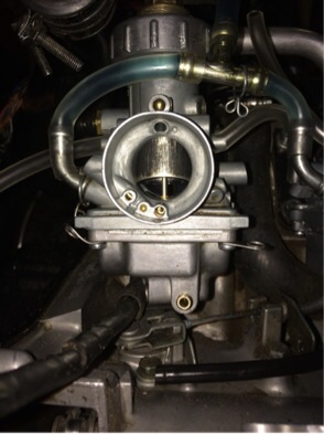

this is exactly what mine is doing as well. If i put fuel in the head oor spray it right in the carb it'll fire up. ive cleaned the carbs and everything in them like 5 times, i even boiled the carbs.I have 125 cpmpression in each cylinder and brand new reeds. What the HELL am i missing?? i kicked and kick with the choke on at WOT and the plugs are dry. If i help start it itll stay running. what else to try?
Air leak? Carb bowel gasket not sealing right? For some reason pilots are not getting air through and from what I understand neither are the mains since it also won't start at WOT
