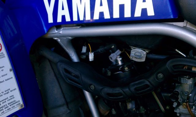

Need to know what these plugs are opinions on why the may be unplugged. The ones just to the left of the petcock. Looking at buying this 2000 model and it started first kick but the headlight "tic tac toe" guard is melted as well as the headlight lens. Don't want any electrical gremlins. Any ideas would help out alot. Thanks Wayne
The plugs are from the T.O.R.S. system. they attach to a safety feature above the carbs. That feature is almost always removed / disconnected because they fail. can I ask what the bike is selling for?

Plug is part of the tors.
I kinda figured it was the tors. It looks like it was two separate plugs (4 Halves) that are unplugged.
Is that a simple way to defeat the tors. Also it stalled twice when breaking quickly, any ideas.

If it stalled when breaking, that just might be the clutch adjustment. It looks bone stock. Get pics of it if you can.
