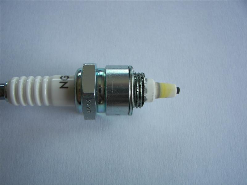

qboronyrican Posted December 16, 2011 Report Posted December 16, 2011 did a plug chop and looking for some opinions if its good...little lean....little rich. http://i43.photobucket.com/albums/e366/qboronyrican/plugchop1.jpg http://i43.photobucket.com/albums/e366/qboronyrican/plugchop.jpg Quote
04zSpittinKlotz Posted December 16, 2011 Report Posted December 16, 2011 lean, go up a coup more sizes till it spits on top then down one size Quote
qboronyrican Posted December 17, 2011 Author Report Posted December 17, 2011 (edited) lean ....really? i thought it was pretty good....thought it was supposed to be a choc brown and 2mm in size? is that not dark enough? Edited December 17, 2011 by qboronyrican Quote
04zSpittinKlotz Posted December 17, 2011 Report Posted December 17, 2011 the way i was taught you need a little more, and i have never cut a plug up just to check it, you want to see the same choc color around the ring of the plug as well, so i look for the rust/choc color on the ring and about halfway up the porcelain, put it back in and RUN IT!!!!! ive seen a bunch of posts about doing a "chop" and a lot of people do, i just see it as a waste imo. Quote

Jereme6655 Posted December 17, 2011 Report Posted December 17, 2011 looks alright to me....might be JUST a tad lean. and i would rather waste a set of plugs doing plug chops than just run them looking at the electrode end. ive been told by more than one sponsor on here that it should be a 2mm ring at the BASE end of the plug....being why you have to cut it down. Quote
RadarRacing Posted December 17, 2011 Report Posted December 17, 2011 That looks real close to me. With a pic its hard to tell, if you want a better read on a plug do it again but make more passes and you will see more color and a better ring. That just looks like a real new plug that hasnt gotten much color yet. If its 2 mm tall then you are right there. Color should be beer bottle brown, if the color is light brown or tan then go up a jet or two till you get the right color and height. Guys that arent picky about jetting may be real close on jetting but theres 15-20% more HP in the last 2 or 3 jets and gettting it right on the money. On the dyno a 60 HP bike thats slightly rich will make 65-70 Hp when its right. Chopping a plug isnt wasting plugs, fouling them is. Good job on tuning yer crap right. Quote
04zSpittinKlotz Posted December 17, 2011 Report Posted December 17, 2011 there we go,,,,, opinions personally i'll run a lil rich, jet it right, and not waste any plugs, with a little bit of light i can see brown in there just fine and look for it on the ring, ive ran the SH*TTTT outta my blaster for 2 yrs and am only at 110 lbs compression, do what ya do, just givin my .02 Quote

qboronyrican Posted December 18, 2011 Author Report Posted December 18, 2011 thanks for the comments guys....ill try going up a bit more but i cant see going up too much more...already at a 162 main but ill try and if performance changes for the worse ill go back Quote
sleeper06 Posted December 18, 2011 Report Posted December 18, 2011 thats damn good bro you can go up one size to be safe but as long as you chopped a brand new plug 6th gear wide open then killed it holding throttle open your good Quote
qboronyrican Posted December 20, 2011 Author Report Posted December 20, 2011 thats damn good bro you can go up one size to be safe but as long as you chopped a brand new plug 6th gear wide open then killed it holding throttle open your good i think i was in 5th wide open then killed it Quote
andrew3160 Posted December 20, 2011 Report Posted December 20, 2011 Looks pretty good to me, you want a ring around the plug to be the thickness of a dime. I would run it. You can always mess with the needle clips to dial it in just a bit more. Here was mine, and I have had no issues since the build a year ago. Quote
2004LEBanshee Posted December 24, 2011 Report Posted December 24, 2011 Id say your right there. You may want to go up 1 on the main just to be on the safe side. If you ride from day to night it might lean out a little on you with temp change. Quote
Tedder Posted December 24, 2011 Report Posted December 24, 2011 I did a bunch of chops when our 1/4 mile drag motors were on gas. This was perfect for us during the summer months. A tad lean (1 jet size ) in the fall. It was with highly oxygenated VP CMP fuel which is no longer made. I'd say your real close but don't forget that what your looking at is only reading the main curcuit. Might go up one if there's no loss in performance. Quote
