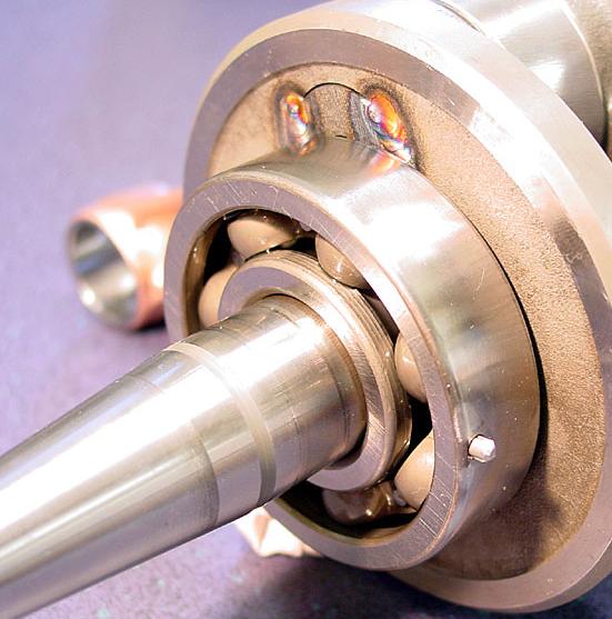

with 20cc domes??? one last thing. wat is the purpose of welding your crank? wat actually gets welded?

The crank is not a one piece design and is built up of pressed in sections. In high HP applications the crank is trued and welded as a safeguard against "slippage" of the interference fit sections of the crank.
Crank slip would lead to the two crank journals being out of phase with each other.
