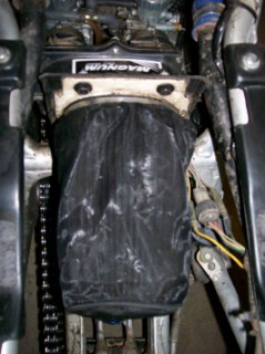

This is my airbox mod, I got rid of the sides and bottom and use the stock mounts and a K&N with a outer wear, I don't have to worry about a pod slipping off, LOL

This is a mod I did to my airbox I run a stock size K&N air filter with a wrap I only use the front section of my airbox cut the sides and the bottom off it uses the stock hangers that attach to the frame and I have never had it fall off unlike the individual K&N pods. A K&N will prob get you a couple hp -
