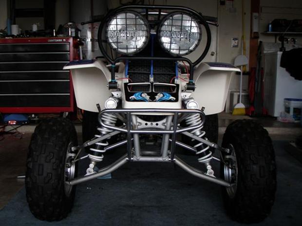

Well after running my yfz arms/shocks with banshee spindles at glamis a few weeks back i was happy but wanted to get my height back so i decided to take it to the next level and get a set of yfz spindles as well,(it gives you about 3 more inches of travel) So with this new travel it allows you to run a longer shock (about 17.5 max) i know others have run 18 and 18.5 but i dont like the idea of having the ball joints stop all the weight of the front end. so after doing some searching i found the suzuki ltr450 shock is 17.25 inches long and i found a set for $150 shipped and let me tell you i went out this weekend to superstition and i was hitting some good jumps and the whoops on pole line rd. in 5th gear and it was soaking them up not to mention the fact that it now measures 12.75 inches from bottom of front of the frame by bumper and stock it was 12.0. i am sure i am not the first to try these but figured it was becoming a popular mod and might save some guys the trouble of searching. it does take a little work because you need to get them all the way forward so the spring does not rub on the upper arm but nothing a few washers cant fix. my only regret is they are not yamaha lol

As long as you can weld anything is possible although i am not sure about using a +2 yfz arm that will be about 8.50 inches (total) wider than the banshee for $250 you can get a set of stock yfz450 arms with good ball joints and s set of shocks. it would be about 4.50 inches wider than stock (basically a +2+1) i just did my swap last week and am very happy so good luck either way you chose.

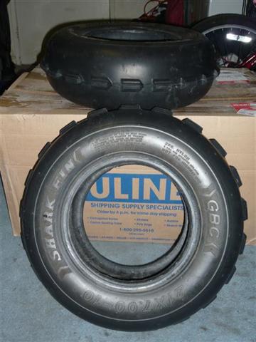

I have a almost new set of gbc 21x7x10 shark fin front tires. they have about 3-4 trips on them and are in excellent condition with nipples still on them. $50 plus shipping or can be picked up in San Diego.

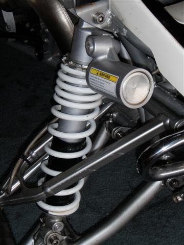

I was looking at my bike last night and noticed my shocks are rubbing on both sides in the back against the upper a-arm ? what the hell has any one else had this problem or is it just me ? i dont know what i could have done differently i have not heard of this happening to any one else. maybe i will just try in put some washers to space it out ? -
