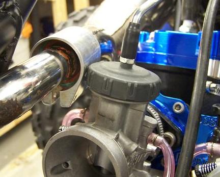

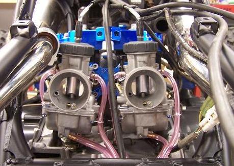

  5. I should say it's only the left side carb, the right side has plenty of room.
  6. Another Pic
  7. Hello, I'm in the final stage of my Banshee rebuild & ran into a big issue. (see pics). The tops of my 33 PWK's are hitting my T5 pipe clamps. If I spin the carb, it fits, but that can't be right. I have a Boss Intake as well. Has anyone had this issue before? Thanks in advance.
