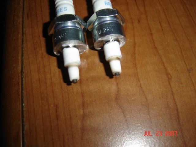

  1. Ok did a plug chop today with 340 mains, they are the right color but less than 2 mm width. Tried to get rid of that sputter right before half throttle by putting the clip on the needle all the way rich at the bottom of the needle and no change. Got in a 27.5 pilot screws at 1.5. Don't know whether to go richer or leaner. Also got some uni pods hooked to the carbs if that does anything. In case you forgot I got fmf gold series fatties, +4 timing, And the above mentioned stuff. Thanks.
  2. Alright ran it again today and the mains look leaner than the last run with 300 mains and I was using 330 mains this time. I was getting good color but not the 2mm height so I now suspect an airleak at the rubber boot from the 2 into 1 filter. because I have some debris in the left carb and it has a little sputter right before it gets on the needles. I check my plugs at idle with a new set and after 10 min were bone white. With the 27.5 pilot will need to fix the leak before I continue. I will try some uni pods because I ride a mix of sugar sand and dirt here in florida.

  5. Here is the latest, got up to a 300 main and the chop reveals a brown ring about 1mm thick, it has a sputtering from right about 1/8 to 1/4 throttle or right before it gets on the needles. Tried a 330 jet and I had the 2mm ring but lighter than at 300. What would be next to remove that sputter, or is it how they run due to the advance?
