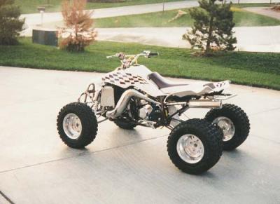

2000twin Posted May 30, 2008 Report Posted May 30, 2008 Ok guys,Long story short i built my shee to out run a 535 HRD Dr Q motor..We raced this past weekend and he was beating me by 3 or 4 lengths.He was getting me hard from the dig but top end I think i can get him.Hers what i have.... 4 mil long rod crank 795 series pistons RB racing aggressive dune/trail port Stock head milled and 19cc domes cut into the head 34mm mtx carbs 310 mains cant remember pilot jets Uni filters Shearer inframe drag pipes 14/42 sprockets with 20" turf tammers Running race gas. Thing spins like a mother and pulls hard up top just seems like when I shift he pulls on me... Any help would be appreciated.. Thanks Jason Quote
Pardee208 Posted May 30, 2008 Report Posted May 30, 2008 Ok guys,Long story short i built my shee to out run a 535 HRD Dr Q motor..We raced this past weekend and he was beating me by 3 or 4 lengths.He was getting me hard from the dig but top end I think i can get him.Hers what i have....4 mil long rod crank 795 series pistons RB racing aggressive dune/trail port Stock head milled and 19cc domes cut into the head 34mm mtx carbs 310 mains cant remember pilot jets Uni filters Shearer inframe drag pipes 14/42 sprockets with 20" turf tammers Running race gas. Thing spins like a mother and pulls hard up top just seems like when I shift he pulls on me... Any help would be appreciated.. Thanks Jason when you shift, DONT let off the gas, shift fast, 2nd gear start! might want to drop a tooth on the rear. when does the 535 out run you, from the start or towards the finish? Quote
shanYE west Posted May 30, 2008 Report Posted May 30, 2008 I've heard Dr. Q builds a mean zilla.. Might want to considers a more aggressive port to compliment your shearer pipes and the 4mil crank. Quote
