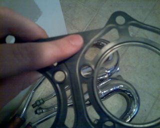

flattrakker Posted November 18, 2007 Report Posted November 18, 2007 ok on the cometic head gasket and id imagine every other banshee head gasket there is an outdent on oneside and an indent on the other side. which way does it go? outdent up or indent up? my finger is next to the indent on the gasket. Quote
samc Posted November 18, 2007 Report Posted November 18, 2007 i have the same gasket set i believe the side that your finger is in goes down like the shape of the cylinders/ Quote
00tbanshee Posted November 18, 2007 Report Posted November 18, 2007 i can see the pic real good but looks to be the way your holding it is the way it goes.just make sure the the ring around the cylinder sleeve(on the gasket) should be bubbled upwards when its laying on the cylinders Quote
