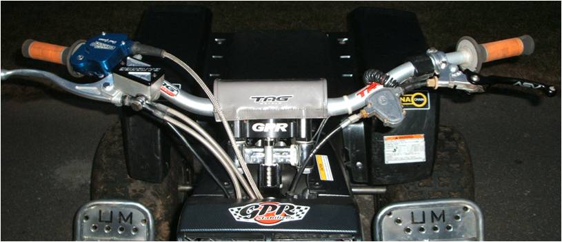

I am 6'1" & I just installed the Tag bar riser with a pair of CR hi bend bars, it is about an inch lower than stock. I like the CR bend because there isn't too much pull back & it allows me to stretch out a little but honestly the stock bar was the most comfortable for me. I think you will need a riser & high bend bar to get close to your stock bars. The riser only adds an inch and a half if you bolt it on top of your stem & bar clamps, you can choose to mount it on the stem & bottom clamp only but I needed all the height I could get. The riser also allows you to use 1 1/8 bars versus the stock 7/8"

im thinking of getting the quad high bend flexx bars with 2 inch risers but wasnt sure if this would be too high. i think the flexx bar highs are 116 mm then the 2 inch risers? theres also the low bend which i think are 92 mm.

I had the lower rise 12 degree flexx bars and they were good, you can always adjust the bar height by inserting the washers they give you that go under the elastomers. It angles the bars different ways depending on how many you add. I like the quad bend high rise style okay, but the lower bend bars look better on the banshees. I say go with the lower bars and use some risers.

i went with the fasst flex quad racer low bend and the rox 2 inch risers. i love the feel and the way it looks. i will be buying a +1 inch anti vib stem in the future and i think it will be at a perfect height for me at that point.
