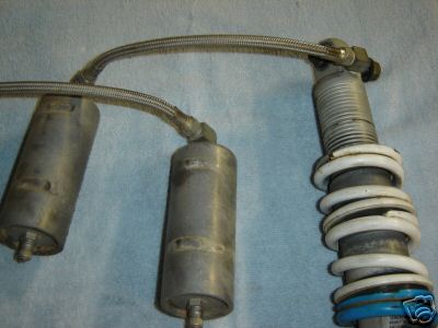

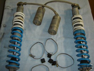

charles_in_houston Posted February 12, 2007 Author Report Posted February 12, 2007 (edited) if those are the same kind of works shocks I got on my 250r then you might be able to use em without any trouble. do they have like a clip type preload adjustment thing on the top? it looks like a bunch of little grooves that this little c clip thing sets in. you could be able to just set the preload as soft as posible so that it gives you alot of sag in the front end and that way the front end wont be as high Yes those are exactly the ones. How do you lower the preload? I'm assuming you needs some sort of spring compressor to get at it or it must be done at the Works factory. With the preload how it is now I can't get them to fit. When I remove the stock shock, the a-arms won't expand enough to allow the shock to go in. That's why I was originally asking about the lowering kit which moves the bottom of the shock out and down which looks like it might work. I just don't know about the extra angle of the shock that gets added and what that would do. Help me understand how I can reduce the preload myself and I will give that a shot for the temp fix. Will that make the ride too soft? Any additional info would be great. Thanks guys! Edited February 12, 2007 by charles_in_houston Quote
charles_in_houston Posted February 12, 2007 Author Report Posted February 12, 2007 ya but they arnt going to fit on the stock a-arms he is going to have to by long travel a arms to beable to use them.and he wants to use them on the stock a arms till he can get other ones. Won't reducing the preload allow me to install the shocks but under slight pressure of the cartridge? The springs are what's keeping me from being able to compress the shock and get it the extra 1" or so down to make it fit in the tower mount. It dosent lack much to make it fit. I could probably get a leaver of some kind and pry it in but I don't know what that would do to the a-arms being under load like that. Not to mention the added ride height of the front end. kaotik1, I got your PM. I do have photos of the shocks and I can take any additional ones. If you are interested in trading 16.25" shocks for stock height, send me the photos of your shocks to [email protected] If anyone else is interested let me know. I can post the pictures here. Quote

charles_in_houston Posted February 12, 2007 Author Report Posted February 12, 2007 Here are some photos of my shocks: Quote
