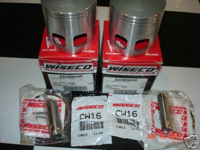

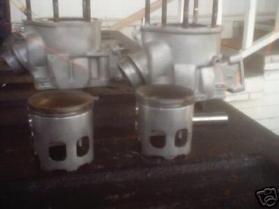

jayzx10r Posted January 27, 2007 Report Posted January 27, 2007 (edited) My builder says that he just open's the window's up a lil bit he does not hog them out or anything do you guy's think that is ok? I dont wanna weaken my pistons up and make it not reliable at all. I can't disagree with anyone elses conclusions and I don't mean to step on anyone's toes, but I personally did this to my 2 RD 350s, my 3 RD 400s, and 2 RZ 350s with no negative impact. I figure that flow is flow. My contention is that if your cylinder is ported, why isn't your piston? A 1/4" can go a long way... Like anything else, if you go too far, you can count on serious engine damage.... I believe that Wiseco offers pistons already ported...their HP series...842s. That is what is so great about these RZ/'Shee motors... They are chain saw buzz boxes. Usually, a well thought out concept works out with good results. This may be one of those opportunities to make some power. Just don't change the timing and be REASONABLE in the amount of material you remove :sweat: if you do!! I'm going to do it next time I change pistons, heck, I thought everyone did it!! Of course, I'm always open to learning something from someone else so if I've been blowing it all this time, It's never too late to change!! Top pic are stockers. Bottom photo is the 842s. Notice the width difference? Not a lot, but a bit.... Have a good one, Jay from SanD. Edited January 27, 2007 by jayzx750 Quote
