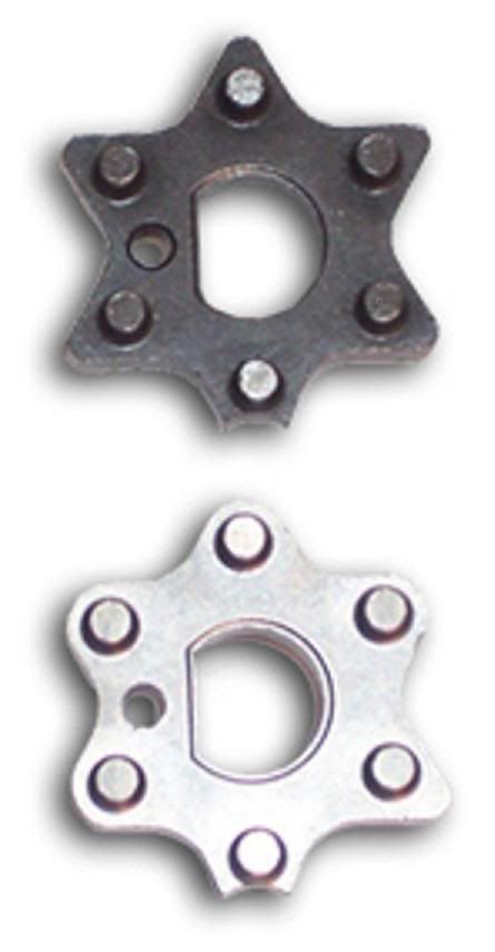

thegroup Posted May 29, 2006 Report Posted May 29, 2006 if ur feeling froggy, heres a pic of a stock and modded shift star. dad just used a wheel grinder on mine and it looked just like the modded on in the pic. Quote
