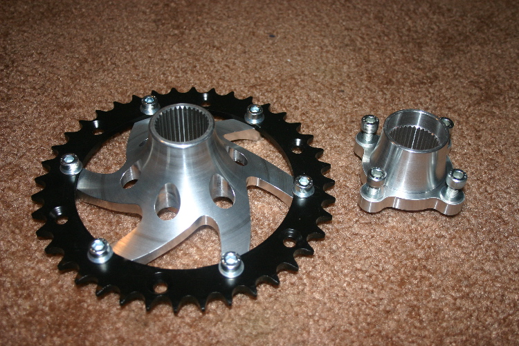

Wallrat Posted April 4, 2006 Author Report Posted April 4, 2006 (edited) Look what came in the mail today! Got both for $192 shipped to my door! Brand new, I just bolted up a new sprocket before snapping the pic. Edited April 4, 2006 by Wallrat Quote
Lepew Posted April 29, 2006 Report Posted April 29, 2006 Aluminum splines do wear out. I have a LSR sprocket hub the splines worn. Aluminum hubs aren't for longevity there for the extra edge to win races and look cool. Use a good grease on the splines on assembly and keep the axle nut tight to prolong the hub life. Quote
Justintoxicated Posted May 2, 2006 Report Posted May 2, 2006 Man your going to be blinging if we go to pismo this summer Quote
