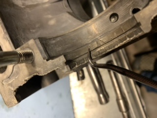

Up north rider Posted October 3, 2022 Report Posted October 3, 2022 (edited) Hello. New to the forum. I’m in the process of rebuilding my engine. Upon splitting my case I noticed some bad gouging on the stator side crank sealing surface. I looks like someone really went crazy with a screw driver trying to change the seal at one point. Is this something I can fix myself or are the cases shot? Edited October 3, 2022 by Up north rider Quote
locogato11283 Posted October 4, 2022 Report Posted October 4, 2022 They're fine. Try to clean them up with some sand paper. You can use some 1211 or Yamabond when installing that seal to close up any gaps there may be. Quote
Up north rider Posted October 4, 2022 Author Report Posted October 4, 2022 Thanks a lot. Will do Quote
registered user Posted October 5, 2022 Report Posted October 5, 2022 some kentucky hillbilly didnt know the seals have a rib Quote
