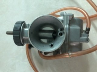

Azeez.M Posted March 27, 2020 Report Posted March 27, 2020 Hi guys I’m new here , and my english is not that pretty will but i hope that you Will get my point I get a New sit of keihin pwk 36 which its a gift from friend , and i’m afraid when i install them that i will lose some lower end power. do you suggest me to go ahead with them or just using my stock carbs current Mods: 4mil cranck, 4mil ported stock cylinders, vforce 4 reeds, sherer infram exhaust, +4 timing , pro design cool head with 21 domes , k&n like filter in box , running a pump gas Quote

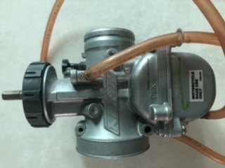

Azeez.M Posted March 27, 2020 Author Report Posted March 27, 2020 1 hour ago, ClaudeMachining said: 36mm is airstriker. I think they are a little too big for your setup. I’m pretty sure its pwk , I attached a pic Is there any issues will happen if it’s slightly big for my setup? Other than losing Some lower end power Quote
ClaudeMachining Posted March 27, 2020 Report Posted March 27, 2020 5 minutes ago, Azeez.M said: I’m pretty sure its pwk , I attached a pic Is there any issues will happen if it’s slightly big for my setup? Other than losing Some lower end power standard pwk is 35mm air striker pwk is 36mm Yeah, you'll loose bottom end. Quote
Keno Posted March 27, 2020 Report Posted March 27, 2020 That is NOT an airstryker. It is missing the fins in the intake, doesn't appear to have a cut away in the atomizer, and it is not a quad vent. 1 Quote

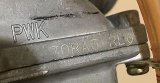

Keno Posted March 27, 2020 Report Posted March 27, 2020 Post a picture of the serial number. I bet it's a 35mmAlso, what # slide are in those. Should be a 6. Quote
gusto Posted March 27, 2020 Report Posted March 27, 2020 Lose bottom but will gain top end. Id run them... Quote
Azeez.M Posted March 27, 2020 Author Report Posted March 27, 2020 1 hour ago, Keno said: Post a picture of the serial number. I bet it's a 35mm Also, what # slide are in those. Should be a 6. I don’t know if its will be clear on pic or not but the No. is 70RA3 RLG and yes the slide is 6 Quote
Keno Posted March 27, 2020 Report Posted March 27, 2020 Yeah, those are pwk 35mm. Should work fine with your 4 mil. I'd run 'em. 1 Quote
