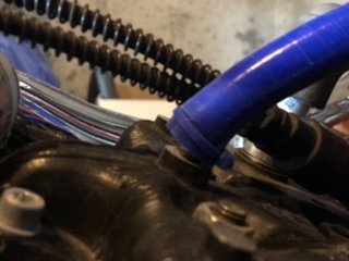

Deets Posted February 2, 2020 Report Posted February 2, 2020 Was riding today, mostly just first and second gear through the woods. Decided to run out through the snow and had it pegged in third for a bit. Directly after it started leaking antifreeze, a lot. couldn’t tell exactly where from, looked like maybe from the inlet to the head. Is there a common problem of this? Quote
Keno Posted February 2, 2020 Report Posted February 2, 2020 Its leaking from the short J tube between the intakes? You might check your clamps or inspect the hose. The coolant intake on the head is bolted on with 2 bolts and there is a gasket between it and the head. Verify the bolts are tight and if still leaking, replace the gasket. Quote

Deets Posted February 2, 2020 Author Report Posted February 2, 2020 Found it, seems the guy that put it all together thinks that zip ties are hose clamps.Sent from my iPhone using Tapatalk Quote
hoppedupandcutdown Posted February 3, 2020 Report Posted February 3, 2020 HaHa, Yep, that one is pressurized too. Quote
Deets Posted February 3, 2020 Author Report Posted February 3, 2020 (edited) 9 hours ago, hoppedupandcutdown said: HaHa, Yep, that one is pressurized too. Every end of every hose has a ziptie. Surprised it didn’t leak more. Need to pretty much rewire the whole bike too. Dude was a hack Edited February 3, 2020 by Deets Quote
