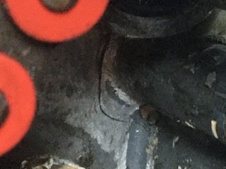

Ayesully810 Posted October 15, 2019 Report Posted October 15, 2019 1 hour ago, HomesteadBanshee said: Thanks man I’ll post a better pic tommorow when the suns out. It honestly starts first kick I think I got a steal for 500 worst case you need new cases and have to tear the motor down and put all the guts into a new carcass. worst WORST case you open the motor and find new issues lol Quote
Keno Posted October 15, 2019 Report Posted October 15, 2019 I’ve been trying to post a better pic but it doesn’t allow me to do itDownload Tapatalk on your phone. Soooo much easier. Quote
HomesteadBanshee Posted October 15, 2019 Author Report Posted October 15, 2019 12 hours ago, Ayesully810 said: worst case you need new cases and have to tear the motor down and put all the guts into a new carcass. worst WORST case you open the motor and find new issues lol Yeah your right and what I paid for it i feel I didn’t do bad even if I gotta do the motor completely but honestly it feels kinda healthy starts first kick, when I get a chance today I’ll post more pics of the crack I’ll try and get the best pictures I can get. Quote

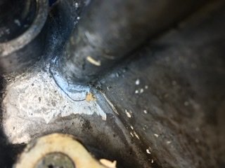

HomesteadBanshee Posted October 16, 2019 Author Report Posted October 16, 2019 I gotta finish cleaning it off the previous owner said he tried in welding it but it never stuck since it was dirty and full of oil, I gotta finish scraping the rest of the jb weld it’s very little amount. Quote
HomesteadBanshee Posted October 27, 2019 Author Report Posted October 27, 2019 Any suggestions, should I weld it with motor on the quad or do I take it all apart. I got all the parts needed for the quad all that is left is getting the cases welded.also I washed her up, I’ll post some pics. Quote

Keno Posted October 28, 2019 Report Posted October 28, 2019 I'm not a welder, but it may he prudent to degrease and preheat the cases. Also you'll probably want to take it apart so you don't melt the seals nearby. Maybe someone who knows how to weld cast aluminum will chime in. Quote
registered user Posted October 28, 2019 Report Posted October 28, 2019 aluminum is a pain in the balls when its oil soaked. the crack is probly saturated along with the backside. if it were mine i would take it apart and clean the backside with acetone in all directions of the crack for several inches. do the same on the front side. V the crack and drill a small hole at each end of the crack so it doesnt take off when u lite up. a quick preheat in a oven isnt a bad idea either 1 Quote
HomesteadBanshee Posted October 28, 2019 Author Report Posted October 28, 2019 3 hours ago, registered user said: previos owner sounds like a tard Na he was a cool dude very honest man.im really dreading on taking it apart completely,I’ve been told by re do banshee parts and others to weld it all together but others say to take it apart, I guess I’m stuck taking it all apart unless I get some type of suggestions not to from some more banshee gurus. Quote
registered user Posted October 28, 2019 Report Posted October 28, 2019 he might of been cool but its clear he has no welding or repair skills. fix it however u want. makes no fucks to me Quote
HomesteadBanshee Posted October 28, 2019 Author Report Posted October 28, 2019 (edited) 13 hours ago, registered user said: he might of been cool but its clear he has no welding or repair skills. fix it however u want. makes no fucks to me I plan on getting it welded it’s the correct way unless buying cases but I’m trying to see if I really gotta break it down because if I do break it down I might aswell just rebuild the entire motor and go through the drivetrain and see and if needed repairs or see something not right fix the problem.l, I was kinda just hoping to fix the minor bs thing drive it till I blow it up, and then break it down. Edited October 28, 2019 by HomesteadBanshee Quote
kawa110 Posted October 28, 2019 Report Posted October 28, 2019 Too much of a leak for me. Make a mess of bike when riding. 1. Cheapest(may not work) JB weld/epoxy2. Attempt to weld on bike(cases get to hot will damage oil seal at countershaft sprocket and shift shaft) 3. Tear down and have welded4. Find good used cases, swap everything over, install new crank bearings, seals, trans bearings and new piston rings. Sent from my iPhone using TapatalkOption 4. Won’t be able to successfully weld those cases without tearing engine down. Sent from my iPhone using Tapatalk Quote
HomesteadBanshee Posted October 29, 2019 Author Report Posted October 29, 2019 Re do banshee parts suggest take off the nuetral plastic cover, the shift shaft and shift shaft seal and get it welded With it together, I just don’t wanna damage it more than I have to,if you guys tell me your advice I would appreciate,I’m just most probably gonna take it all apart. Quote
