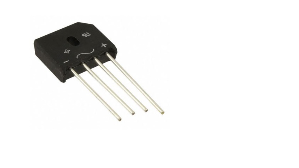

Guest Andy G Posted September 15, 2017 Report Posted September 15, 2017 You guys are awesome! I'm glad I posted this question on bansheehq. My 12" light bar is 72 watts. Which means that if I need to convert 12v ac to 12v dc using a rectifier, I'll need a rectifier to support a minimum of 6 amps (72 watts / 12 volts = 6 amps). I picked up a 100v / 8amp rectifier for $1 at a local electronics shop. This should work for what I need. I watched a youtube video where the guy indicated that when you rectify 12v ac, it actually output about 17v DC (which is fine, because the light bar supports 10 - 30 volts DC). Even with 17v DC, I only fall at 4.2AMPs (72 watts / 17 volts = 4.2 amps). Attached is a pic of the rectifier. Sound about right? Quote
Keno Posted September 15, 2017 Report Posted September 15, 2017 That's what you need! Yeah, the peak will be around 17v DC but the average voltage will be 10-11v DC. You'll still have a little flicker at idle, but won't be as bad. If it bothers you, put about a 2200uF or larger 25v capacitor across the positive and negative of the light. edit: should be 22,000uF and can actually be a little smaller. Quote
