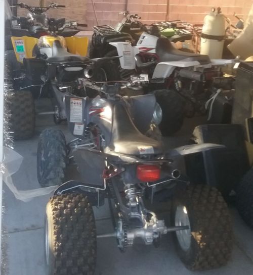

bertmann73 Posted June 19, 2016 Report Posted June 19, 2016 Hello all. I am an older rider and have built many desert toys out here in vegas such as a honda v-twin dunebuggy and a 250r 3-wheeler to quad conversion. My 2 stroke knowledge is inferior to my 4 stroke knowledge but i have always managed to keep things running until i met the Banshee. I have been riding with my nephew, Manny, since he was old enough to get on a bike, and now my son has joined us. We bought the banshee new in 2005. It came with FMF and GYTR aftermarket parts from the showroom. He fell in love at first sight. I co-signed and we took it out that day. After a year the top end failed duet to infiltration through the crappy airbox setup. we bored it, got new pistons and put it back together. 6 months later it siezed up and bent a rod. We found a stock donor engine and swapped it out. at least i think its stock... Anyhoo, that engine ran for a while until we began to get misfires and only one cylinder seemed to be running. I replaced the electric carb throttle cable system with the manual ones from the donor bike just cuz i hated those things and they took up too much work space. Still same problem and then we lost the water pump gear and it overheated. we replaced it with a metal gear and got a new alluminum radiator. we put it back together but it wont run. I have gone through the carbs with a fine tooth comb and it still wont idle and the right cylinder gets hotter that hell. I am giving up at this point and gonna tear it down and rebuild it. I am hoping to gather a closet to stock rebuild list that includes a slight bore and jetting at a low cost with anything else you all may insist i do to make it a dependable ride. I am not trying to mod this thing as we dont have time for all that and the bike has plenty of power for us as is. I just want it to run so Manny can smile again when he rides (he has to ride the raptor 350 right now.........no fun) Just point me in the right direction of what to get and things to check. The bike has FMF Gold series Fattys and FMF power cores and the carbs are most likely jetted for those from Yamaha for a stock Cylinder. Please help save another banshee Quote
