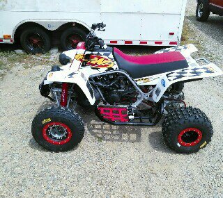

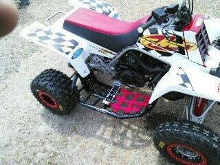

Some pictures, still have all stock parts, right down to a new factory set of decals including warning labels, didn't add a arms, or swingarm or shocks yet, hiper offset did enough for a short time. Sent from my Z813 using Tapatalk -
