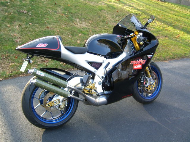

lt1bird Posted December 17, 2014 Author Report Posted December 17, 2014 This is the 485cc cheetah powered bike.....280LB wet..... aprilia rs250 based... Quote
sleeper06 Posted December 17, 2014 Report Posted December 17, 2014 That's real nice bro good shit Quote
lt1bird Posted December 18, 2014 Author Report Posted December 18, 2014 thanks guys....I love it too.... built it a few years ago...now finally have time to tune... Quote
