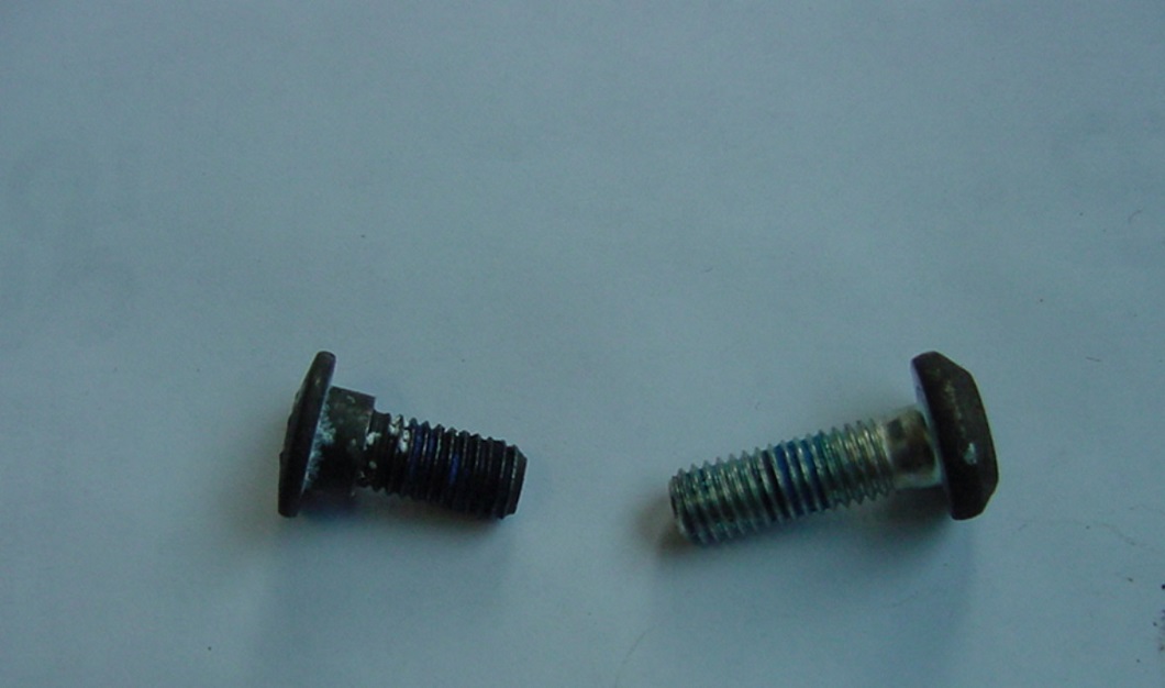

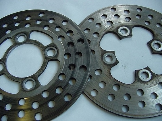

hoppedupandcutdown Posted July 11, 2017 Report Posted July 11, 2017 Hubs are different, notice the back of the wheel studs and the recess for the rotor bolts Quote
hoppedupandcutdown Posted July 11, 2017 Report Posted July 11, 2017 rotors are different too, but probably interchange Quote
hoppedupandcutdown Posted July 11, 2017 Report Posted July 11, 2017 rotor bolts must match the hubs Quote

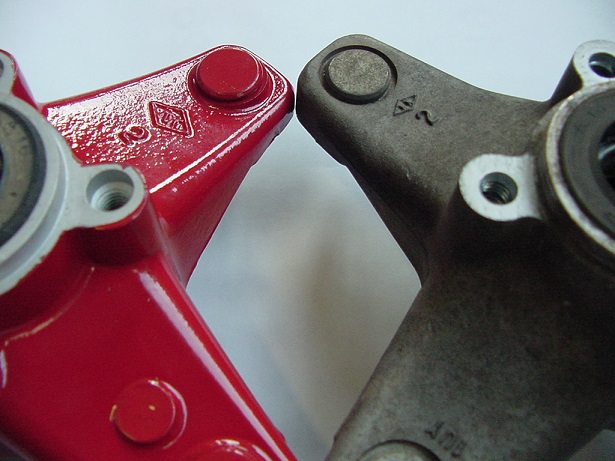

ginger Posted July 11, 2017 Report Posted July 11, 2017 it looks like your one side has a a arm spindle, but no caliper, and the other side has a j arm setup. so you are going to want to replace one of your spindles so they are the same setup one each side, either another j arm spindle, and run all the j arm brakes, or another a arm, and 2 calipers for a arm brakes. Quote

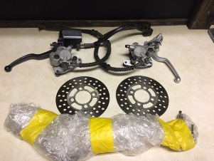

Chukkinsod Posted July 12, 2017 Report Posted July 12, 2017 I have a full Front brake set up including master and lever for sale...PM if interested Quote
