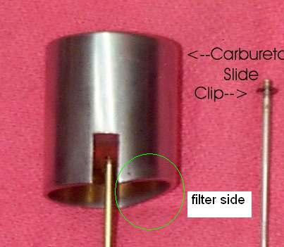

hoppedupandcutdown Posted September 9, 2013 Report Posted September 9, 2013 are your slides in the right carbs? look through the air filter side for the cut outs. Quote
