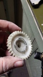

  4. IT WORKED! I'll see if I can get the other pic loaded up.
  5. F it. I'm tired of trying to re size these stupid pics. Been trying for about 2 hours now. Yes it was the water pump gear that had melted. There is another pic of white plastic melted into the bearing. I'm sure I could re use the bearing, but better safe than sorry.
  6. I've been on about three or four trail rides with my Banshee since I bought and two rides ago, it started burning coolant. Like all of it. So thanks to you guys and your info, I was able to figure out what the problem was.
