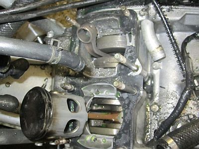

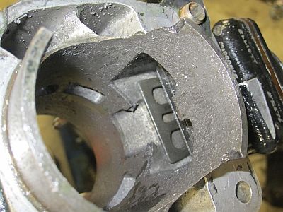

slag_350300 Posted March 27, 2011 Report Posted March 27, 2011 Went for a ride last week and was 4 th gear on the throttle when it made the worst noise Ive ever heard an engine make. Check out these pics. Must have had an air leak somewhere. Time for a 4 mill build. It was stock crank with paul turner ported cylinders bored .60 over. The ignition side piston looks fine. When I pulled off my clutch side pipe the wrist pin, remnants of wrist pin bearing and piston particles fell out of the pipe onto the floor. Quote
MRPINK Posted March 27, 2011 Report Posted March 27, 2011 (edited) Went for a ride last week and was 4 th gear on the throttle when it made the worst noise Ive ever heard an engine make. Check out these pics. Must have had an air leak somewhere. Time for a 4 mill build. It was stock crank with paul turner ported cylinders bored .60 over. The ignition side piston looks fine. When I pulled off my clutch side pipe the wrist pin, remnants of wrist pin bearing and piston particles fell on the floor. haha DAMN! probably more than just an air leak Edited March 27, 2011 by MRPINK Quote
locogato11283 Posted March 27, 2011 Report Posted March 27, 2011 probably more than just an air leak, and what name of port work with no intake bridge The motor coming apart probably broke the intake bridge. I doubt it was built that way. Quote
slag_350300 Posted March 27, 2011 Author Report Posted March 27, 2011 The motor coming apart probably broke the intake bridge. I doubt it was built that way. Yeah if I could oif uploaded bigger photos I would have but the intake bridge was broken out and theres alot more damage than in those pics I just uploaded that angle. and yeah I know it was more than an airleak. Quote
