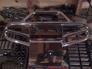

Heres another one.
Sorry about the typos in my last post. I just realize I can't edit them...
Would have been perfect but that damn dent screwed me. I guess there is only so much you can sand away from the bottom of a beat up used skid plate...
And by the way... I had about 15 hours of hand sanding into this ONE skid plate. I know tools would have made it go alot faster but I'm a cheap ass. :rotflmao:
