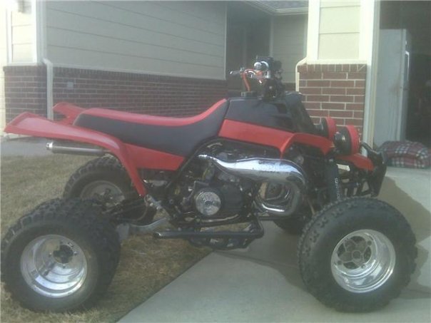

sheefreak Posted February 26, 2010 Report Posted February 26, 2010 This bike is a duner/dragger so it never sees branches, woods, etc. I did this paint job 5 yrs ago w/good Dupont Chromabase paint and a good clear coat and I used an adhesive promoter and sanded the plastics just enough to lose the shine. Those plastics look really good still and have taken some abuse(mostly from transport, strapping, etc.) over the years. If you do it right and don't skimp you won't be touching it up every time you go riding. Now if you are talking about a trail/mud bike, all bets are off. Might as well use the cheap paint and keep plenty on hand for touch up. As a matter of fact, I plain wouldn't paint the plastics on a trail bike. Quote
