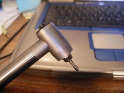

Yeah the #1mc is AWESOME!!! Thanks we build those ourselves. It is expensive but to our knowledge we sell ours for less than any other company. Thanks for the good feed back. For certain jobs you really need the left hand rotation carbide cutters. We have a hard time keeping them in stock in but they are worth the money if you take porting seriously.
I am definitely beginning to take it seriously. This is my first set of cylinders as far as porting them goes, but it's fun and kind of addicting in a strange way! On the #1 MC, what should I be lubricating it with?
