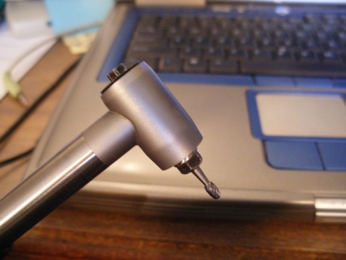

2003LimitedBanshee Posted April 18, 2009 Author Report Posted April 18, 2009 i believe that snope on here also uses the cornwell unit. there used to be a cornwell tools saleman that drove around my area, but he hasn't been around for years. i have no idea how i would get one and now that i think of it, my bluepoint grinder is the exact same. 2003LimitedBanshee, do you have to use left hand carbides w/this thing? i've been using right hand carbides with this thing and having the cutter end of the cutter, sticking out the side of the spindle w/the collet. now, i see in my cc specialties catalog, that they show a pic of #1mc handpiece, w/left hand cutters, but sticking out the spindle, that's opposite the collet. am i just using the tool wrong? i would think that it should still work properly w/right hand cutters?? No, you don't have to use left hand at all with the #1 MC. Just I guess in some spaces being able to use a left hand carbide will make it nicer, make the tool less likely to grab and try to "run" in the port. If you are going to use left hand carbide, you have to turn the burr the opposite direction, so the only way to achieve this is to have the burr coming out the opposite side. There has to be something going on here. When you ordered the replacement, did they ask you again what size collet you wanted. Something has to be going on here. Back when I bought my #1 MC everyone was telling me that was the only handpiece to buy, mine works awesome, and up until now I'd never heard of anyone having a faulty issue. I tried snapping some pics of mine tonight, but my stooooopidddd photobucket won't pick them up from my phone! Let's see a pic, maybe we can see what's going on? Hopefully I will throw my freshly ported cylinders on tomorrow night. The Yamaha shop wanted $70 for a pull on the dyno and it was a two week wait. I KNOW they are NOT that busy, WTF! So, everyone should have an idea what T5's and other bolt on's add up to, so my after numbers should be good enough. Cylinders mic'd out fine, so just going to throw a quick hone on them and run with the stock pistons for a quick go, but then going to pull and have them honed and get a set of wiseco's in there to hold up to the revs. Quote
mopar1rules Posted April 18, 2009 Report Posted April 18, 2009 this pic shows how i am trying to use the handpiece.... Quote

ccspecialtygirl Posted April 22, 2009 Report Posted April 22, 2009 i believe that snope on here also uses the cornwell unit. there used to be a cornwell tools saleman that drove around my area, but he hasn't been around for years. i have no idea how i would get one and now that i think of it, my bluepoint grinder is the exact same. 2003LimitedBanshee, do you have to use left hand carbides w/this thing? i've been using right hand carbides with this thing and having the cutter end of the cutter, sticking out the side of the spindle w/the collet. now, i see in my cc specialties catalog, that they show a pic of #1mc handpiece, w/left hand cutters, but sticking out the spindle, that's opposite the collet. am i just using the tool wrong? i would think that it should still work properly w/right hand cutters?? Did Roddy help you with figuring out why you were having so much trouble?? Yeah right hand rotation carbide in left hand rotation will cause a bumpy ride and can even break your collet if your not careful. We have people all over the world that use our #1mc daily and LOVE IT and don't have any trouble. We sent out your left hand shape C in the diamond cut but I don't carry the left hand in alumni cut. I can try to special order you some if you need me to. I hope this was the problem and not the #1mc. We also sent your collet for the #44mc and credited your card for the return of the original #1mc minus your new products. The #1mc you sent back worked fine but it can be a confusing handpiece to work with. Your new order didn't go out yesterday but it will be going out today cause I finished it yesterday after UPS picked up. Hope you got it figured out now and back up running. If need anything else just call or write. Quote
mopar1rules Posted April 22, 2009 Report Posted April 22, 2009 (edited) Did Roddy help you with figuring out why you were having so much trouble?? Yeah right hand rotation carbide in left hand rotation will cause a bumpy ride and can even break your collet if your not careful. We have people all over the world that use our #1mc daily and LOVE IT and don't have any trouble. We sent out your left hand shape C in the diamond cut but I don't carry the left hand in alumni cut. I can try to special order you some if you need me to. I hope this was the problem and not the #1mc. We also sent your collet for the #44mc and credited your card for the return of the original #1mc minus your new products. The #1mc you sent back worked fine but it can be a confusing handpiece to work with. Your new order didn't go out yesterday but it will be going out today cause I finished it yesterday after UPS picked up. Hope you got it figured out now and back up running. If need anything else just call or write. diedra, i got your message on my phone and on it you said that you are shipping the 3/32" collet?? i needed a 3/16" collet for the #44 handpiece.....not the 3/32". hopefully you shipped what i wanted, and just called it the wrong size....LOL. also, i didn't want a left hand aluma cut. i wanted a 1/8" cylinderical radius end double cut left hand burr and a 1/8" cylinderical radius end diamond cut left hand burr. so, you don't carry the 1/8" cylinderical radius end double cut left hand burrs?? thanks for being so easy to work w/thru this confusion and such w/the 1mc handpiece. later... Edited April 22, 2009 by mopar1rules Quote
