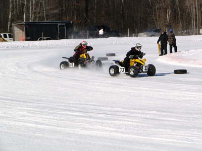

A Sway bar is the next best thing I did for myself after getting the studding down. I run 1 inchers in with no liners then I fine tune the screw for the best bite and self cleaning. They will leak a bit in time . I run the Michigan ama series and have never thrown a stud yet. I keep air on hand but dont need it much. Blow the tires up to about 20lbs when you studding them up, when your done let the air out this will tighten things up a bit. I have found ice riding is an art form just trying to get your shee hook.
oww bad pic, your behind a four poke

motodrumer58 good idea with letting the air out i think i need to do that with mine i have been running my tires real high at 10psi i think i am going to try normal 4 psi i am getting to much traction on the corners and my left rear is at least 6" of the ground sometimes i've gotten the handle bars jerked and get the left side up a bit, (scary)
Damn 4 strokes theres a v force i am have a hard time keeping up with mostly on the straight aways normally well see what this up coming week brings me though

I am faster than those four pokes just trying to get my shee to hook. They beat me off the line then I play makeup all race. I did get that guy by the time the checkerd flag dropped for first in the heat. Ended up 5th out of 20..
[/quote
I would like to say I was lapping him ....... in due time..
