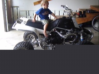

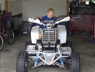

flint Posted December 2, 2008 Report Posted December 2, 2008 well im buying the -2 swinger this week and already ordered the sprockets 14/38. that length chain will i need to work with this set up. when i go home in march i waan just be able to bolt it all together and run with it. i dont want to hvae to dick arround with cutting links out of my chain. pluss its time for a new one anyway. i also bought a 2 into 1 carb set up w/ a 35mm kenith carb. now just have to get the shocks all done and im ready to rock. also got a black radiator cover and looking for blask rear fenders. or i will throw the white back on the front and get a nice graphix kit. sorry for the crappy pics im trying to get my wife to sennd me new ones but getting her to do anythgin with my 4 wheeler is like trying to pull teeth. let me know what ya think Quote
flint Posted December 2, 2008 Author Report Posted December 2, 2008 i also have new tires and rims waiting to be put on. itp red lables with 18in kendals on the back and 20s up front. people say they dont like them but i had them on my 250r and they hooked up great. Quote

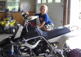

flint Posted December 2, 2008 Author Report Posted December 2, 2008 (edited) lol cant keep the boy off the shee he loves it. Edited December 2, 2008 by flint Quote
KlotzBanshee Posted December 2, 2008 Report Posted December 2, 2008 Nice shee! :beer: Not sure on the length you'll need, but you'll likely need to cut the chain for that setup. Use a dremel or die grinder, makes cutting links out a piece of cake. Stock is 104 links if I remember correctly, so you'll probably need a few less than that, but new chains usually come with 110 links so I think cutting is gonna be unavoidable. There are a few guys on here that run -2 swingers and will know more about how many you should run. Just remember Quote

chevy7398 Posted December 3, 2008 Report Posted December 3, 2008 when i put my -1 on i lost 4 links Quote
