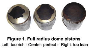

yeah you were lean. the lean state makes the top of the piston hot and when the fuel mixture comes in the cylinder it causes lots of carbon on the top ofthe piston. the opposite is true if you are rich you get piston wash, the fuel washes the carbon off the top of the piston. perfect jetting will leave a 1/2 inch diameter chocolate brown light carbon circle right below the spark plug hole.

yea i meant lean don't know why i said rich,im getting up there in age and having brain farts more often i guess.i was wondering the heat range of the plugs you was running cause everyone wants a hot plug but when you start advancing timing and doing port work etc you want a colder plug and a higher octane fuel.i couldn't really tell much from your pic's need pic,s with more angles of the pistons and the other parts.the pistons do look like they were running lean though from what i could tell.did you have any metal flakes on your plugs.what color where your plugs when you pulled them.also did you have anything done to your head like milling or rechambering.how much compression did your motor have prior to exploding.im running 340 mains on stock carbs so i would say you was running lean 4 sure.when you bought your ported cylinders you didnt do any research on jetting?on you rod that broke i have seen b4 rods breaking from a crooked cylinder bore.i had a buddy that broke 2 rods until he figured out that he had a crooked bore from someone we both know that don't bore our cylinders anymore.
