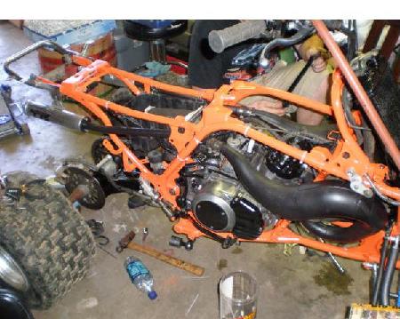

278 Posted September 21, 2008 Author Report Posted September 21, 2008 Here's some pics of how they came out Quote

278 Posted September 23, 2008 Author Report Posted September 23, 2008 Yeah haha I havnt tried it on a frame but Its worth a try, it took like i think it was $12 on the paint to do my pipes silencers like in the pics, that was with 3 cans and I think it took like 1 1/2 or 2 cans to do them. I am going to use the rest on my cylinders like i said once I get them back and I want to do a little research and developement and try them on other metal perts, its almost like powder coating though the parts have to be able to with stand the heat Quote
