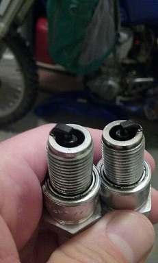

  3. I ordered the jets today as the Yamaha dealer by my work which is 30 miles from home had nothing larger then a 220 mains. I guess todays 4 strokes and all the FI bikes this jetting at dealers this carb shit is a dying thing. I got the 30 pilots and 280 mains. If the temps do not hold I will be out of commission with this until spring. I normally ride in temps down to 45 degrees and up to 90 degrees, much more then that wen you get wet makes your feet cold all day long. I had bought all new gaskets and OEM air boots with all OEM clamps and clips. I'd think there is no air leak, however I can not preform that lead down test as I do not have those tools. I think the half assed shop threw it together and collected some cash before they close the doors for good. I can try other plugs but this is what came with the bike and what the shop also said to run. I noticed a few online threads about running the same plugs so only thing I can do is try the ES plugs and see if results are different when I get the jetting closer to the ball park. It's not dusty where I ride. If you do donuts for 30 mins in 1 spot then it will be but if you running up a hill and off to another one there is little dust and its all behind you. summer months are not even bad. It's not like a dry MX track in September where I ride...your lucky to see 5 guys out everyday. Attached below are the photos of the plugs I got 2 hours on with 25 pilots and 310 mains per what JR's cycle shop did. Thank you for all the help so far. In a few days I will post any update results.

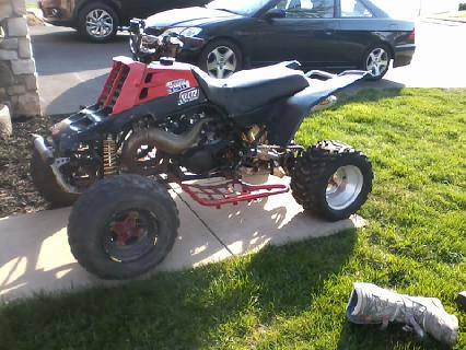

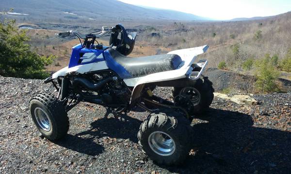

  7. Black and red was the project bike. Blue and white is the result after I fixed it up. OK guys here are the jetting specs. 25 pilot 310 main AF screw 1.5 turns out from seated position BR8EG plugs FMF full fatty exhaust open air box lid EHS screened and prodesign foam filter No reed spacers or boost bottle Anyone seem something not right? my pilot should be larger and my main should be lower. Per FMF jetting specs. This shop hosed me...and today I find out when i went back to tell them about the issue they are going out of buz by thanks giving...wow total crap. Thanks in advance.
  8. Once I am back close to the bike I can tell what jets are in it. I noticed the shop didn't write down on my receipt what they put in it. The bike is in a shed right now and I am 30 miles from it. I can try to get those jet sizes tonight perhaps. Plugs are NKG BR8EG Pilot Jet (TBD) Main Jet (TBD) Exhaust full FMF fatty Open air box lid with foam filter and no snorkel. No reed spacers or boost bottle. FMF states 30 pilot and 260 main for the mods I have. I'll let you guys know in a few days, hopefully tonight or tomorrow. Not having my garage due to renting while house in being built really hurts garage time. Gave as much info as I can right now. Thanks.
