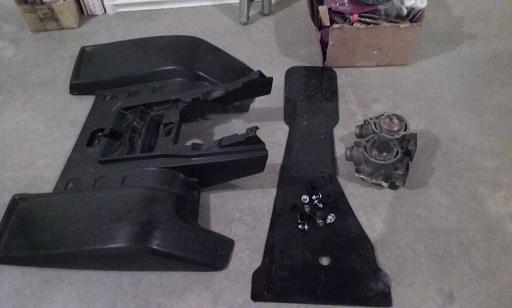

I have some spares I no longer want. Skid plate had a few rides on it but comes with all mounting hardware. It has a lifetime warrenty so if you break it you sent it back. I have the peperwork. Cylinders on .60 bore with pistons, rings bearings circlips. Came out of a running banshee, look to have a few bores left also, not sure what the max is on these, but can be sleeved I know also. Headgasket never used Rear OEM black fenders, no craps, a light burn or rub hole from pipe but only on 1 side and not big either. NO front fenders sorry Not sure what this is all worth, make me a fair offer and pay for shipping and I will let it go. 717-675-4472 or contact me on here. I have closer photos of cylinders but it will only let me up load 1 photo right now.
